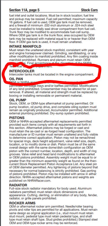

I have been told by at least 4 people, I've discussed this combo with, that the stock intercooler has heat soak issues that would prevent this combo from being a viable car outside of class. Looking in the rule book there is nothing stating you must run the stock intercooler so this seems to be a very easy fix, just run a bigger one...
Are you saying that I can run a larger aftermarket intercooler in Stock Eliminator?
I'm saying the rulebook reads this:
INTERCOOLER
"Intercooler tanks must be located in the engine compartment"
I'm not sure how they could enforce a ruling of the intercooler having to remain the factory unit with this rule...
INTERCOOLER
I believe this is meant for the supercharged CJ, Copo, and Drag Pak cars.
