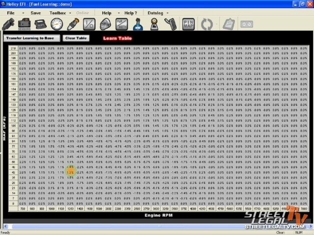

After a run Ed, you click on the LEARN TABLE and everywhere the system added or subtracted fuel ( in closed loop) is recorded. It is a % of fuel corrections .. You can then click on "transfer to base" and the changes (all, or partial, whatever you want) are automatically added to your base map, and next time no closed loop corrections are needed for the Holley to keep on target. It's pretty accurate. Only takes about 3 runs and all the WOT stuff above the 2 step are done. Below that, still has to be done the old fashion way, by hand and trial and error. I think the Fast System will do the same thing from what you are saying, except you must do it cell, by cell ..
Do you ever have problems the idle after you transferred the changes to base? I have mine at learn only above 5000 rpm and anything below is open loop but I still have idle problems after I transfer the changes.
