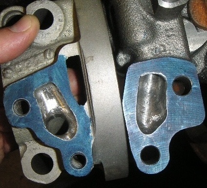

These little modifications may also help?
Name:	360 oil mods3.JPG
ID:	46369   Click image for larger version
