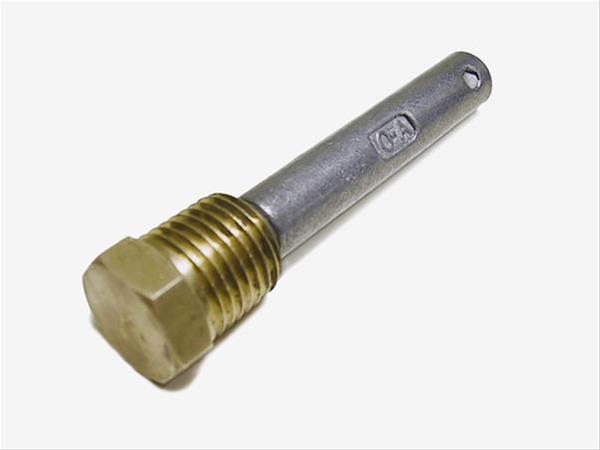

Thanks for the info everyone. Someone please post a picture of a anode.I know if I go into the H ware store and ask the lady for a anode, I will get that funny look.LOL

Lyn,here's one from Champion rad it screws into the water drain.Summit also sells them. gsa612

https://www.summitracing.com/parts/flx-32060/overview/

Originally Posted by Dave Sheehan View Post
That won't work..
He needs magnesium..
Bob Mulry 7516 STK
