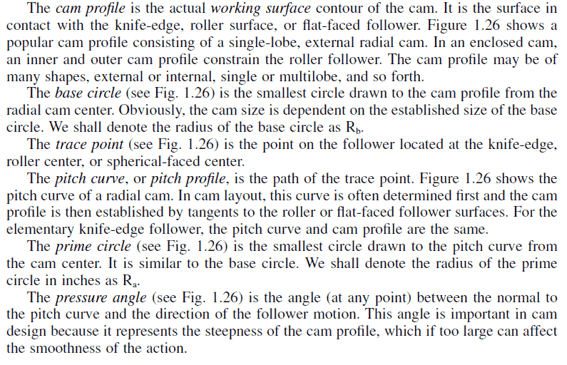

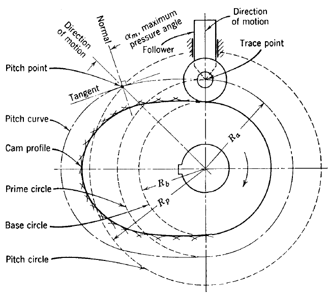

Ignoring pushrod angle against the lifter. A flat lifter / cam really produces no side loading.
Again ignoring pushrod angle against the lifter. A roller lifter / cam will produce side loading. Look at pressure angle.
While a roller lifter doesn't the max velocity limit of a flat lifter, at does have other limits. Again look at pressure angle.
Stan

If you look at what I posted. "It is all in there" The "Trace Point" / "Pitch Curve" will change as roller wheel radius increases or decreases.
Stan
