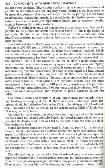

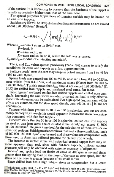

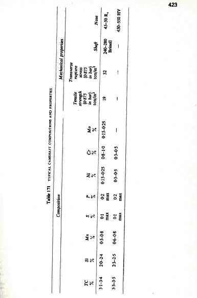

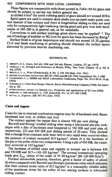

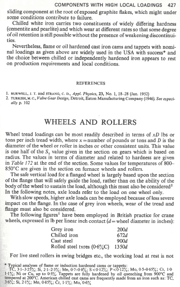

In a thread on another forum they were talking about that many years ago Isky sold "Chilled Iron lifters". If someone today could manufacture these it might solve the problem.
Stan

The Isky chilled iron lifters are not harder than either the tool steel or the Johnson Hy-Lift hardened tappets. The only thing harder is carbide or ceramic.

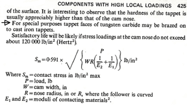

Alan,
That was talked about in the pages I posted.
Stan
Or Titanium
