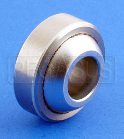

If you can trust NHRA's wording ,a speherical bearing is one designed to allow angular, or radial misalignment ,such as would happen to a locating strut rod during normal suspension travel.
I've used these with a weld cup at the front of a Mopar strut rod, in place of the rubber.
Name:	3076 speherical brg.jpg
