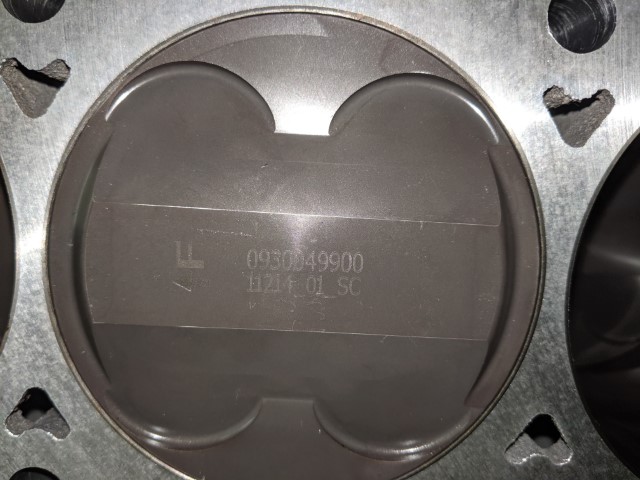

Here is the dirt on the piston & heads. First photo is my piston, which I have found out is in fact the original Mahle piston. This will fit all 11-14 cylinder heads and is the correct piston for all of these combos. So thankfully I don't have to buy new ones.

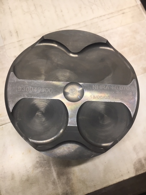

2nd photo is a piston with magically the same number on it, but quite a difference! It won't fit into the chamber of the BR3E heads used on the 2012 302/325, the 2014 302/350, or the 2011-2014 302/380. However it does fit into the chamber of the Boss 302 head used on the 2013 302/350 and also the 2015-up Gen 2 Coyote heads, as well as the GT350 Voodoo head.
So how was this piston ever legally used when it doesn't fit the correct head?
It goes deeper than this though, Jim absolutely knew what the original and legal piston was, he even posted a photo of it here in 2013: http://classracer.com/classforum/sho...64&postcount=2

As for the Pistons they will fit just fine you either don't cut yourself on your head for the minimum CC or use a 0.15 thicker head gasket or don't push the piston out of the hole.
It is a different person than the original factory Pistons I know this because Don car is a factory car but when I ordered Pistons this is what came any backyard engine assembler can figure this out really easy its engine 101 make sure the piston does not hit the cylinder head.
Because you have a minimum on all engine specs does not mean you have to put it there.?

Or you can use the correct head at minimum CC with the correct valve diameter, the correct gasket, the correct piston at 0 deck, and guess what? The dome does not strike the chamber and the valves do not strike the valve reliefs! Imagine that!
