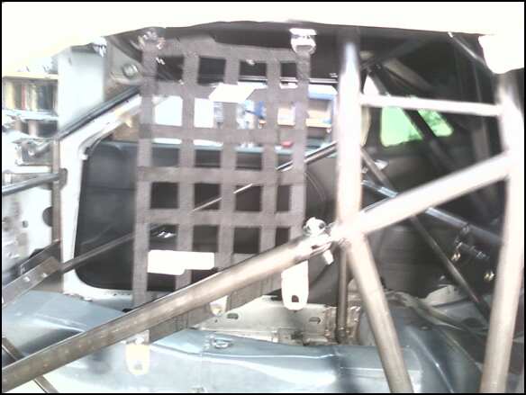

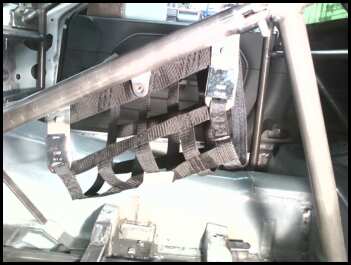

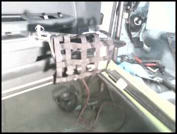

Sorry I did'nt get a chance to send an E-mail ,I've been going nuts trying to get everybodys work done .
Here are a few shots of my setup .
Similer to what Mark suggested,altho I dont like the rod attachment, since the net wants to slide down the rod.
Stroud makes my nets and they match my patterns every time.
