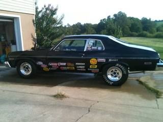

Old 06-08-2015, 01:37 PM   #8
FLEMING
Join Date: Aug 2003
Posts: 264
Likes: 51
Liked 55 Times in 26 Posts
Default Re: 30x9 Slicks Nova
I have a 74 and run the Tall 30X9.0 (94" rollout) hoosiers.. I cant remember wheel offset but they will fit.. i had to remove a small amount of the inner lip of the wheel opening at the top but not noticable from the outside.. The tires do rub occaisionally on the inside when turning very tight..

Old 06-08-2015, 09:46 PM   #9
Wizard17
Join Date: Feb 2015
Posts: 5
Outstanding!!!!!! Thank you very much!!!!!
Beautiful car by the way!!!!
One question, I assume those are 8" wheels?
