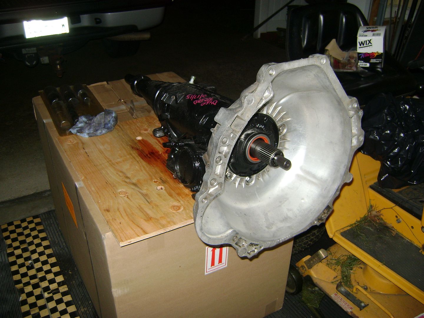

I'm at my wits end trying to get my 68 Mustang 302 out to the track and I'm about ready to replace the transmission. It's a C4 from TCI that shipped with a case that wouldn't fit the transbrake I bought. The case was thread in and the brake is push in. I got a push in case and had a local trans shop rebuild it with the internals of the TCI. The issue is broken front pump seals under load. I have gone through about three of them and the car has never made a solid run down the track. The bell housing is an SFI unit that has been machined so that fit isn't the issue.
Short version: I'm ready to call it quits and order a new trans before it starts snowing or something stupid like that. Any recommendations for a good trans vendor? Performance Automatic and Hughes are on my look list.

Thanks for the quick replies. The actual trans - the gear part - seems to be OK. I'm most concerned that I picked a converter with too high a stall speed for the street/strip application that I wound up with.
It's a TCI StreetFighter with a 3000-3500 stall. OK for a trailer car but I think I need something more like 2500. I have 3.89 gears and a CompCams solid roller with a .585 lift. It has a power range from 2200-6500rpm. With a 28 inch tire the math I've been able to find tells me I should have a stall of around 2500-2700 rpm for a 60 mph cruise to get the trans to lock up.
With stall speed closer to the bottom of the power range is should street and cruise better. I give up a bit at the strip but at least I get there to race.
PA has a better trans brake with an internal solenoid and deeper oil pickup so I'm going to start with ordering that. The TCI brake/valve body I have has a rather shallow pickup and might have starved the trans under acceleration. Part number 26306.
They also have an 11 inch converter with a stall of 2200-2800 on a 10.5 bolt circle. Part number 26212.
These are both items that I would have to order separately no matter what trans vender I go to if it doesn't fix the problem with fluids (gears seem fine - no grinding), so I won't be stuck with more parts if I do replace the trans.
As much as I love the NorthWest, stuff like this makes me wish I was back in Ohio. Toss it in the truck and run up over the border to Joy road. End of story.
