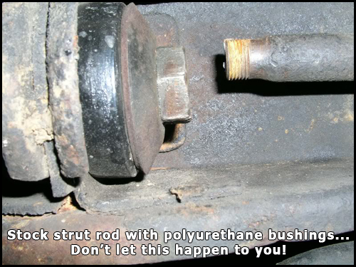

This is likely what they are talking about. I'm sure that GM cars have a similar set-up available to them.
http://www.qa1.net/qa1_motorsports/d...trut-bars.html

Those rods/shafts go from the lower control arm to the front of the K-member on each side.
What's unusual is that the NHRA statement specifies the strut rods in the header. But in the body of the letter, they talk about the entire front suspension in general!
So are they going to have suspension teardowns in the barn to look inside all of the pivot points now? Fords too!

I put a call in today to a NHRA tech guy to help clarify what is meant by the wording in the post. I do not believe it is a worry to the GM cars, but could effect the Fords and Mopars with the front strut rods. Remember how an old Mopar would shimmy the front tires on lauch sometimes, that is what will happen again if this rule is enforced. The front strut rod has to be secured and stable for the car to run safely, especially at 150 plus MPH. This will not happen with the old Mopar setup, a long rod with two rubber bushings trying to hold it steady. Dyno

A few companies make replacement polyurethane bushings for the strut rods which are stiffer and more durable than OEM rubber.....and legal.
