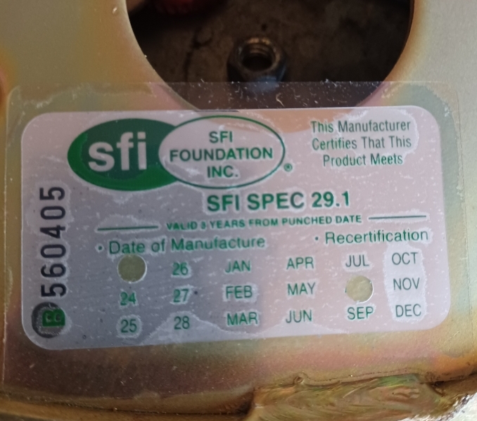

When you get it please give us a picture of the "official" SFI tag on your flexplate.
Looks like any other lol. But here it is.

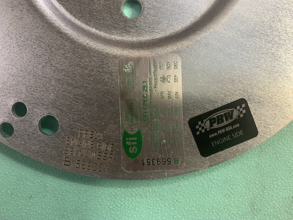

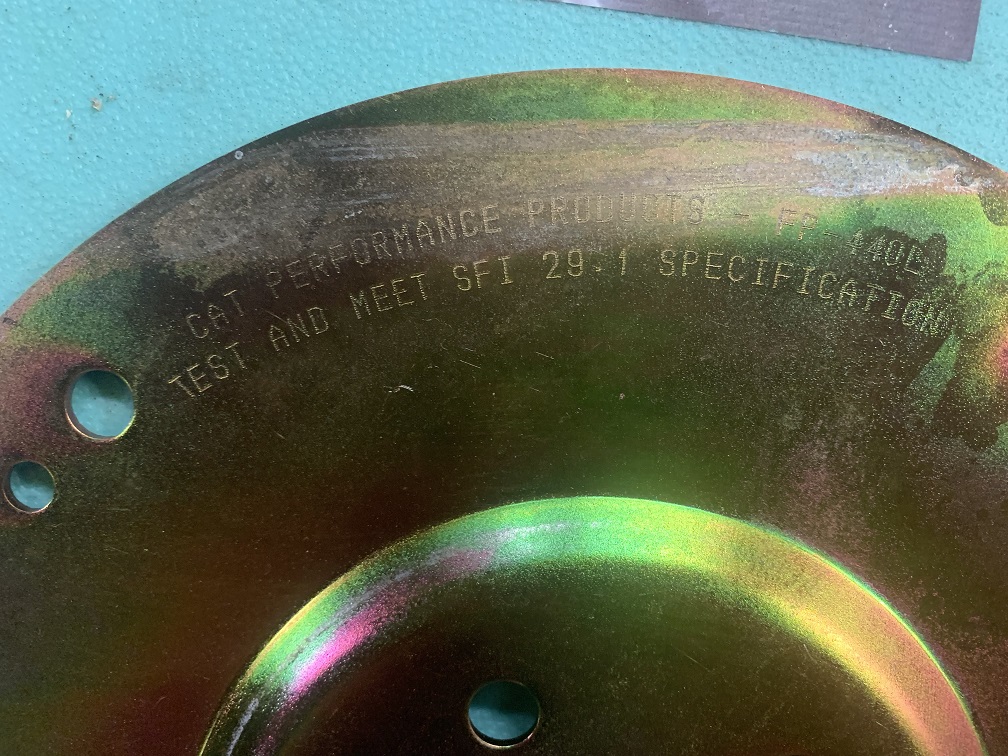

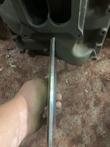

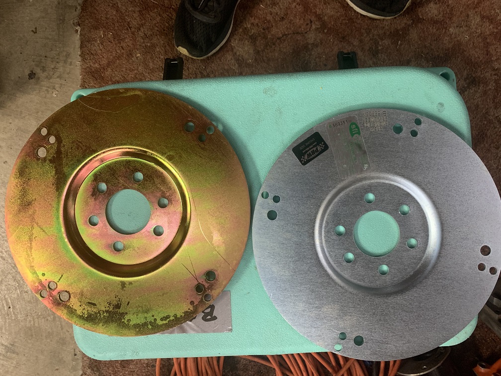

Default Re: SFI flexplate mandatory in all v8s Jan 2024
The gold piece pictured is what happens when you check eBay for an SFI flexplate for curiosity's sake. No sticker, weird engraving..."CAT" product...need I say more? The silver one is a PRW from Summit which is noticeably thicker than the CAT. The CAT is literally just a hair thicker than an OEM Chrysler. I would have did a comparison with a stock one, but I only have one stock one left, and it was on the back of a motor on the engine stand.
