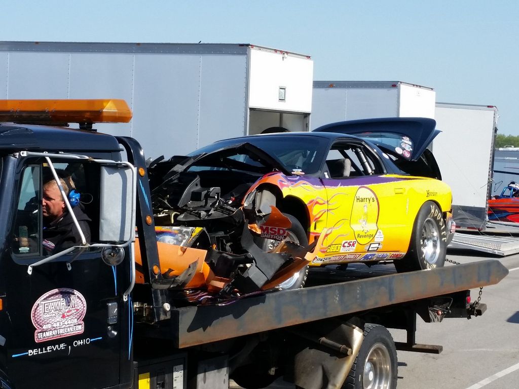

I will chime in here on Safety. Go back to Norwalk Div 3 earlier this year....an A/SA and a P car hit at the top end. The A car was torn up very good (mainly because it was mostly.....uh non metal....both drivers where okay, but it should have brought the safety issue to light for many people. I have said to many people, many times it worries me. Since its only Me I can help in an accident that is why I wear a 15 suit, Hans and put a fire bottle in our SS car. COPO worries me more than the Challenger since you can't get out of a COPO with your helmet on if the door won't open.
ID:	25572   Click image for larger version
ID:	25573   Click image for larger version
