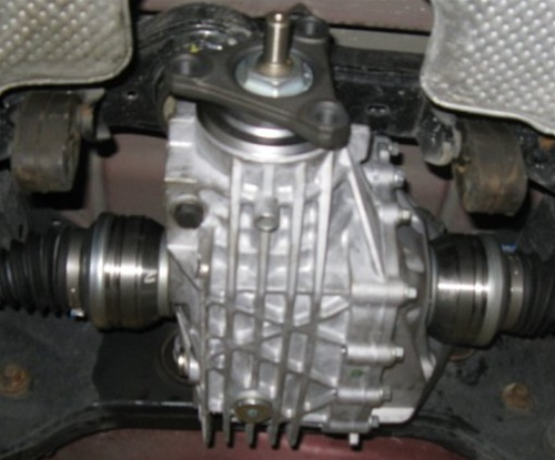

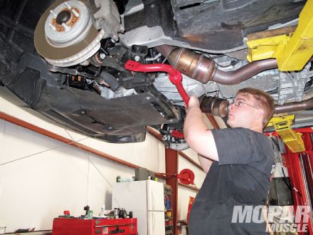

The Challenger has an independent rear suspension from the factory and just like all the previous independent rear suspension NHRA has allowed an approved design so that a solid rear axle can be used. Here are several pics of the factory stuff(hope these loaded correctly.
ID:	2883   Click image for larger version

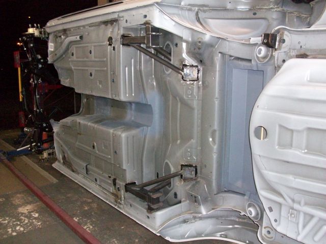

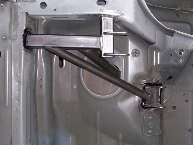

Hey guys dont get to excited.
The extra attachment points are for testing purposes only just like race pak data loggers in stock and super stock . The attachment points are straight from the Drag Pak Manual. Most of the Drag Pak cars look very similar under the rear.
The new Camaros also have independent rear suspension and will have to be fabricated as well.

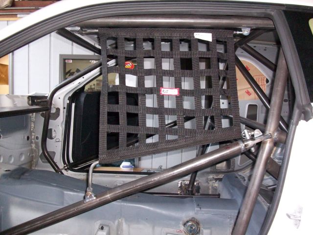

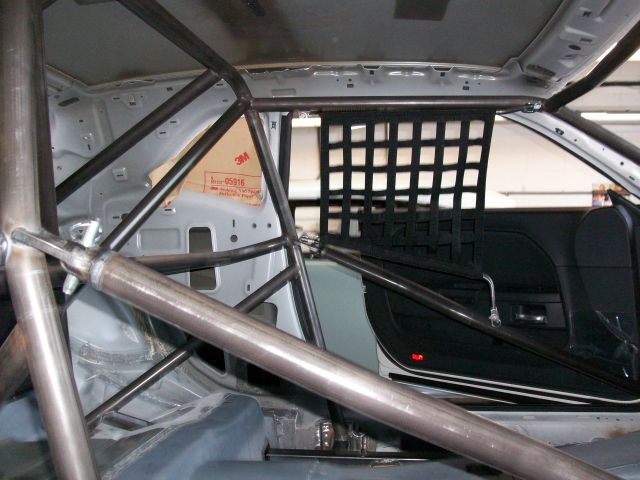

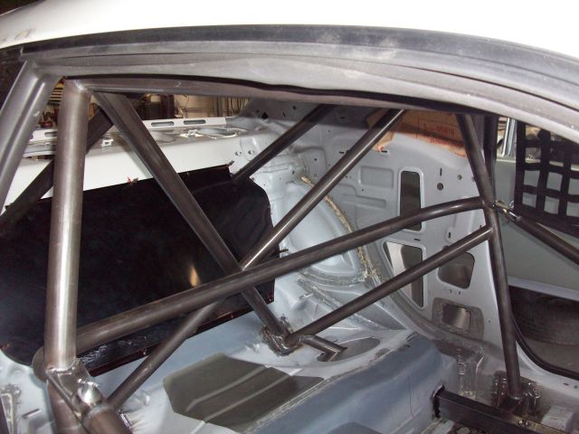

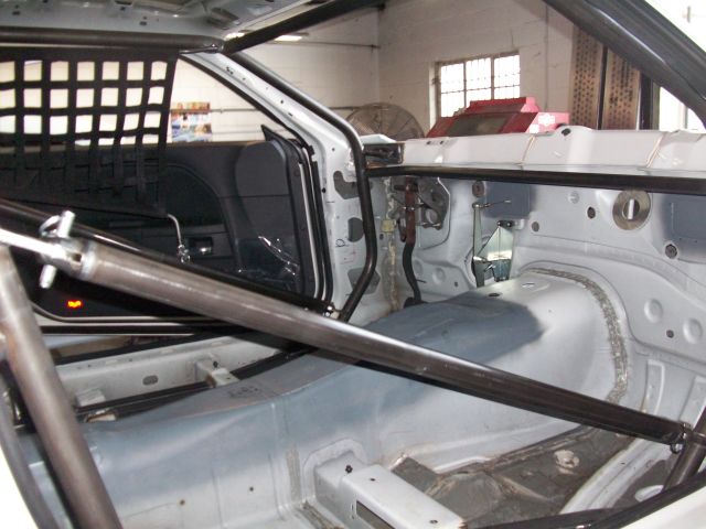

I guess I didn't clarify the "attachment points" I was looking at. But, from what info I info I ever got regarding ROLL BAR/CAGE installations, for stock eliminator it was "limited" to SIX attachment to chassis, REGARDLESS of whether car has frame or uni-body. I was not referring to the multiple four bar locations; that's another story.
My apologies for the confusion.
I still like these cars cuz ya don't hafta deal w/old, rusty stuff!!!!

Regarding the attachment point issue, I think your looking at an old, outdated rulebook. There are full cages in Stock Eliminator cars. Don't forget, there are sub 9 second A cars!

It still has STOCK spring and shock locations as per the Book!
