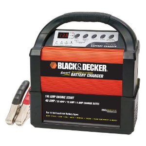

I have this Black & Decker that I like a lot. It was recommended by a racer friend with three cars and three of these chargers. It has settings for wet cell, AGM, and Gell Cell. Works great with the Optimas in the race car and the deep cycle wet cells in the trailer.
http://www.amazon.com/gp/product/B00..._ya_os_product
