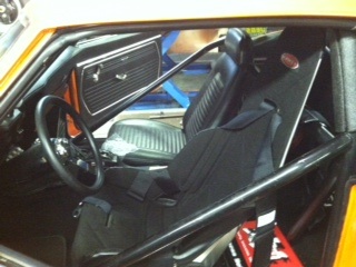

Here's a side by side comparison on a 69 Camaro I did .
Yes , they do not have the classic look , but your chances of not being injured in a crash are significantly lower with all the support the seat offers .

Sorry , I'll have to try the photos later , terrible bandwidth here at E town for me.

Here you go

I just used a set of Kirkey's in a 69 Camaro Stocker that saved nearly 60# over the stock seats.
There ya go...
