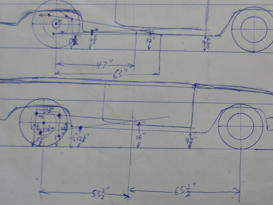

Oldtimer, that DID go to a list of links. None of them seem to address the what is desireable as a drag racing application.
Not bad there, Leif... but again, no practical diagrams indicating the desired geometry.

Here's a link to a VERY rough sketch that I did up, after I took a whole series of very acturate dimensions:
http://www.bruneauperformance.ca/62b...eometry900.jpg
Bottom picture is exactly as the car is right now.
Upper picture is after my proposed lowering the rear 1 1/2 inches.
The 63" dimension, is a result of lowering the front loer control arm mount at the frame ( not permitted ).

Make sure the lower link connecting the rear end to the frame is running down in the front at least 2 degrees. Park the car on a level surface and step back and look at it visually first. the bottom bar must run at a down angle ( lower in the front ) in relationship to the rocker panel. If it is running up it will not hook up even on the best track with new tires. You may need to adjust the ride height to correct this problem if it exists. Had the same problem with my super stocker.

Make sure the lower link connecting the rear end to the frame is running down in the front at least 2 degrees.the bottom bar must run at a down angle ( lower in the front ) in relationship to the rocker panel. If it is running up it will not hook up even on the best track with new tires. You may need to adjust the ride height to correct this problem if it exists.
Mike
that bears repeating
all said
THAT is exactly what I am experiencing... no traction, no matter WHERE the tire pressure is !
Mike, it would be basically impossible to make the lower control arm rake "down", while even remotely staying within the rules.
By lowering the car though, I can get a lot closer... and the upper arms will provide that snap down ( up on the body ) on the axle housing when it tries to rotate back under engagement.
Thank YOU, Mike !
