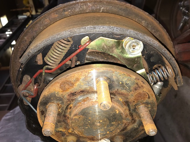

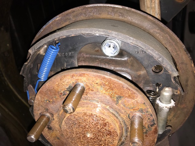

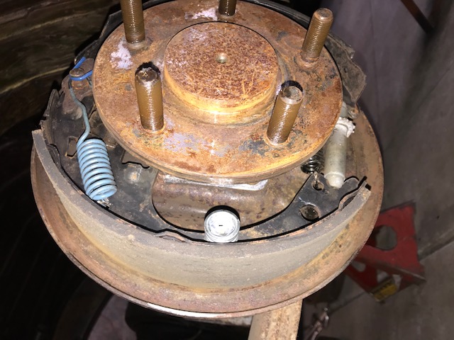

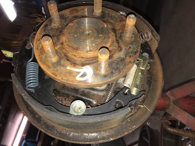

I have it back together.
The manual star adjusters were a bit too long, but the manual adjusting springs work. I used the original auto adjusting star wheel with them. The manual springs keep the adjusters from turning on their own.
I found a return spring in the kit that replaced the short return spring that was used with the auto adjust set up.
There are two before and two after pictures. The after also shows the E- brake hardware removed.
They all got turned 90* somehow.
