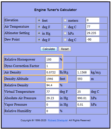

Check this out.
https://wahiduddin.net/calc/calc_hp_dp.htm
Ron Ortiz 2102 STK

Originally Posted by Ron Ortiz View Post
I have not used it so can not say how well it works.
It look like it uses the DynoJet SAE J1349 Dyno Correction factor as 100%. Most people will have had their engine on an engine dyno which uses SAE J607. Notice the DA = 1946 at 100% on this calculator. J607 at 100% is a DA = 0.
Stan

Not sure if I understand you, why would you use -90 for dew point.
As I now look at it again. I really should have used something lower. While I did get Relative Humidity to 0% and Vapor Pressure to 0 in Hg there was still 0.01 hPa Vapor Pressure.
Stan
