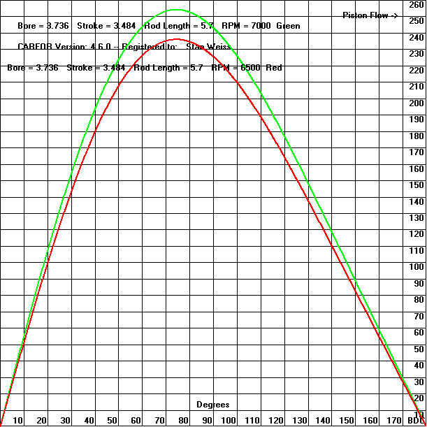

You can also look at what some call "Piston Flow Demand". This is calculated by using engine RPM (Time) and change in Volume above the piston. This graph is a 305 ci @ 7000 RPM
