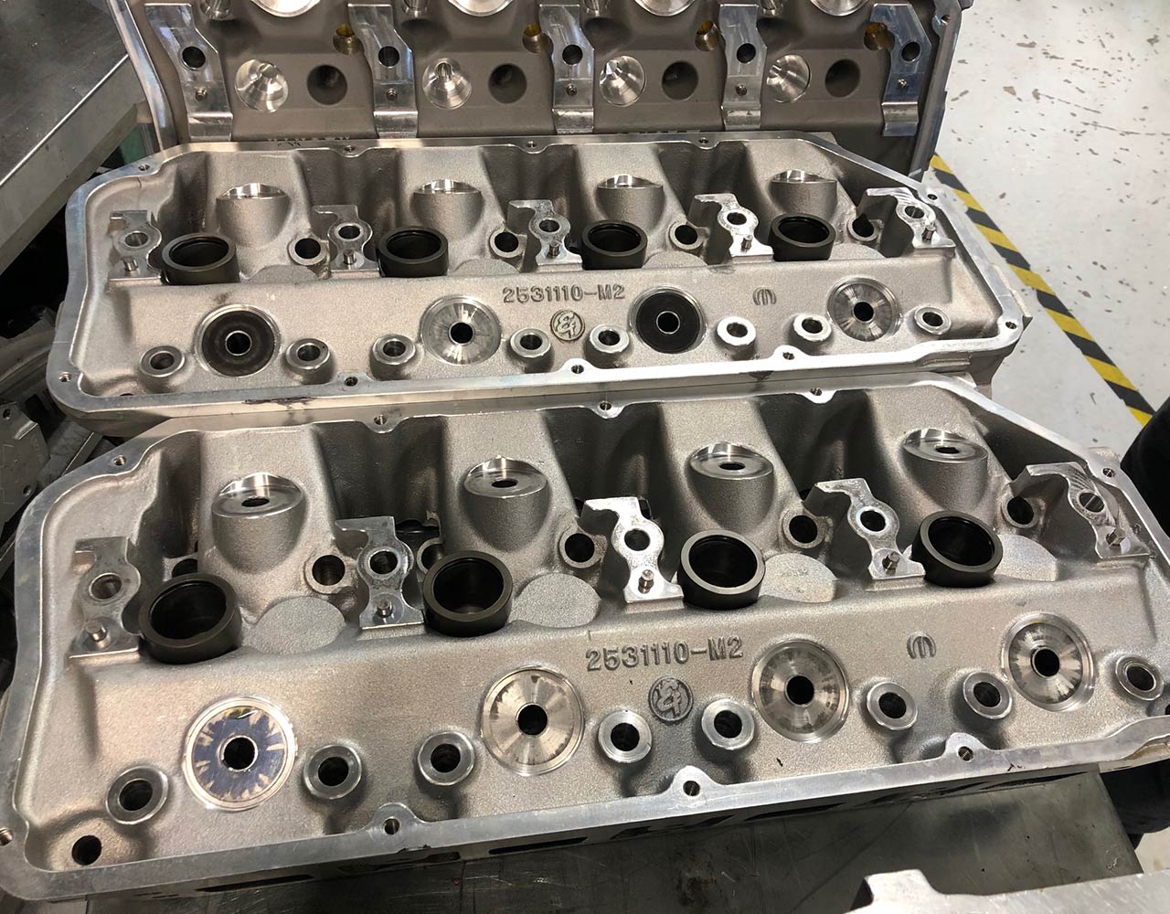

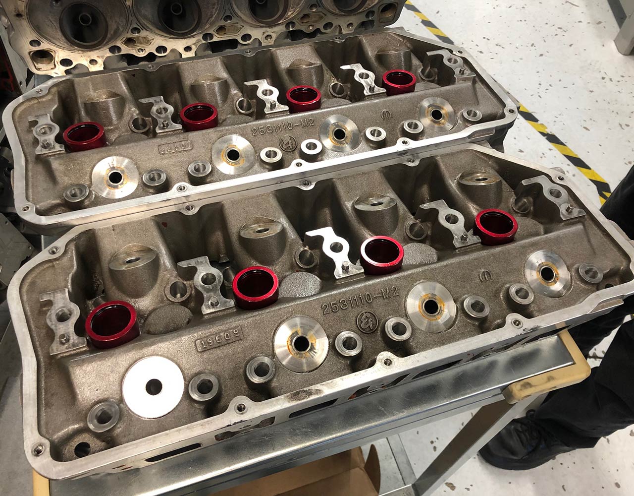

These heads have been available for 10 years from Mopar. This was the head we put on the 528 crate engines. Edelbrock told me they have a P.O from Mopar and are scheduled for late December. -Ray Barton
ID:	65284   Click image for larger version
