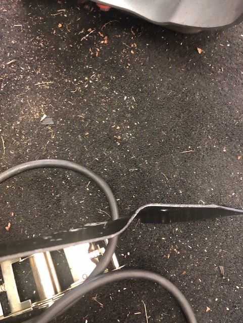

I'm not sure where CE is sourcing their material these days. I bent the hell out my mid plate after about 10 runs. They're 0.90" thick I believe. I ended up having to weld two of them together and rosette weld all over the place to get them rigid enough.
Rotational or forward/aft bending? Anything that leaves hard should have travel limiters that keep engine/transmission from moving in any direction.

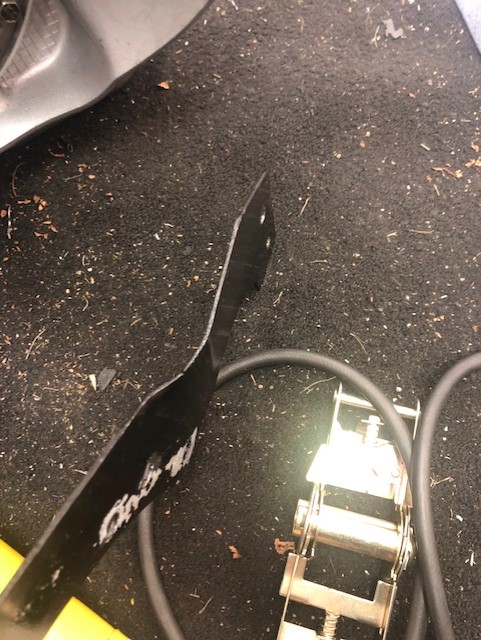

Thanks Phil. I have 1" chromoly tube limiters with rod ends on both sides of the engine.
Here are photos of the bends.
Somehow, it's allowing the engine/trans to still move. Had a dragster once that would bend the plate with only 2 inches between the block and side rail - the limiters were on the frame rail which would move on launch. Moved the limiters to a tubing junction and the movement went away. Can't allow movement if it's placed correctly. Chassis twist, or flex, may be doing it. That's kinda ugly.
