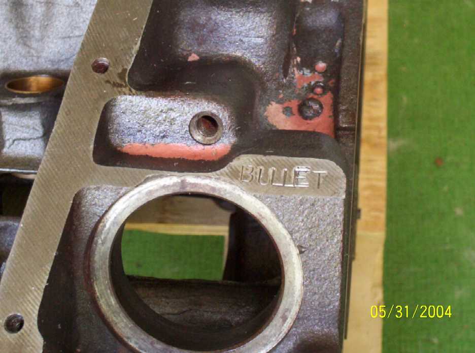

What was the deck height of that block? It looks like it might have been an old SS block that had been cut around .100". I have one of Bullet Bob's old blocks I got from Jim Hale via Tommy Slaughter. The valley rail had been cut too and it left a flat like yours.
Name:	1968 Hemi Block_BULLET.JPG

I have an old Barnett SS Hemi with a similar deck height based on the flat. I haven't pulled the heads off of it to measure that one.
