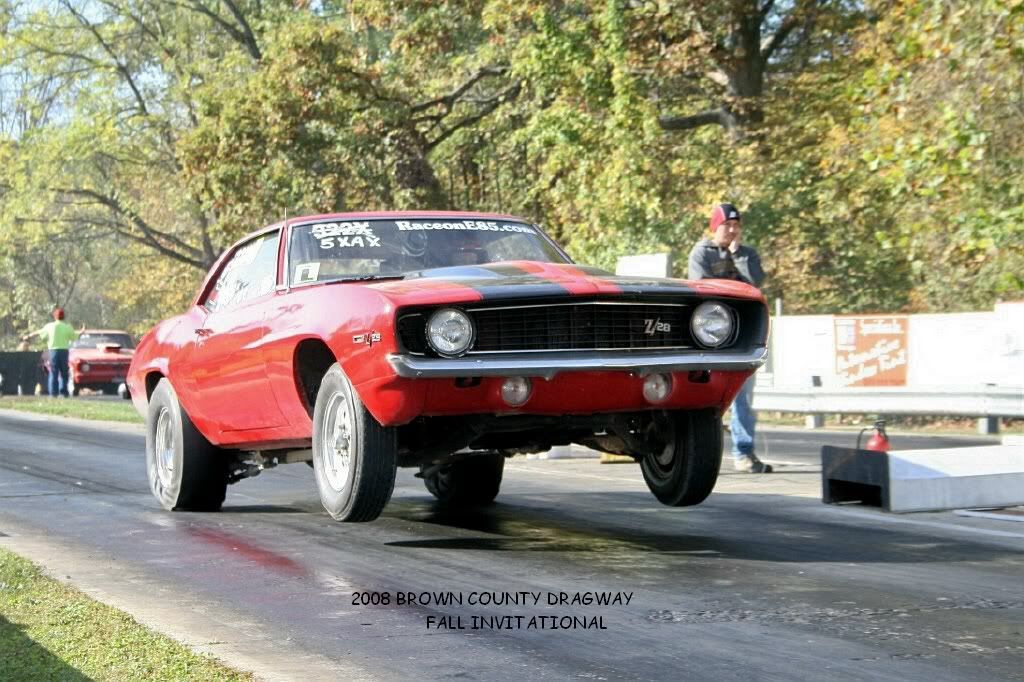

Here is a picture of how it left before. Straight as can be.

the problem most likely is not shocks. One time I got to the track and found I had a broken shock mount. I just took both shocks off of the back of the car. The car ran just as good with out the shocks as with. I had monoleafs and ladder bars at the time. Car ran high tens at the time with 10.5 tire. I would check for a twisted axle tube on the rear. There is definately something wrong with the car. I have not had to use a sway bar on my camaro.

I think you axle tube might be turning in the housing. Check the plug welds.

Wow....I dig a hairy ride, but the other pics well, I put a box of diapers and a roll of tp on the dash of the TR7 when it was together, I think I might have actually needed them on that launch. Then again if I can get the chally to launch that hard Ill be in heaven.....
Something changed somewhere. Simple, I dont know enough about chassis setup on a drag car but my dad always said, "Something Changed Somewhere" the trick is to find it, 9 times out of 10 for me its the thing I was sure hadnt. Breakage bent, even on something I just checked and voila......
There is an OLD trick used on bikes (yeah yeah) but frames with low torsional rigidity like the Kaw triples and Suzy trips we used a scribe mounted to a bolt touching a pad (usually a rearset plate) Not as fancy as electronic thingies but it works....maybe one on the rear housing 1 on the chassis ? see where the flex is occuring. Ive seen 2-3 inches of flex on a bike frame of a kaw triple, hence the nickname "Widowmakers" but you were good before, now youre not something changed right ? Grab a coulple nuts and weld on a scribe at a 90 deg angle and bend it so it touches a suface somewhere itll leave a mark behind.....?
Just guessing out loud here.....wow.......that looks like it would be fun to keep straight....

Here is a pic from this past weekend.. Its 5 times better than the first week out but still pretty bad, anti roll should be here this week and got a few more things to check out....

I just wanted to let everyone know that the anti roll bar fixed and solved my issues!! I went with the DM Products bar and it fixed everythinhg. Thanks for all your help!

Its amazing what that little bar back there can do as far as stiffening and keeping a frame from twisting.
