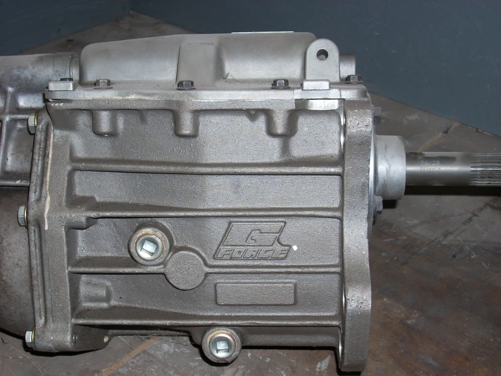

Dallas, did you machine this yourself (magnet collar on the shaft) or did you farm it out to someone else ? We are class rule restricted to T5's and Tremec's and I am want to mount a sensor for the input shaft data logging on our G Force T5. Because of the transmission design and no one making a sealed tapered bearing, G Force prefers not to help us with this project

Damn Yankee
Join Date: Jul 2007

I have a input sensor on my jerico in my ss/i car that is exactly like the one Mark built for his. I did alot of research and no one makes a kit to do this, including jerico. There is no way we could see to mount it to read directly off the input shaft. My machinest made a slip collar with a magnet that installs on the cluster. We drilled and tapped a 1/2 hole in the case and used a 1/2 bolt with the center machined and tapped to accept the sensor. My trans. is a older bottom loader and was easy to set up with that bottom cover removed. I use a computech system and it will convert the main drive ratio to 1:1. I have a new jerico trans. that was just finished last week and they installed the collar and drilled the case for me. The new trans. does not have the bottom cover so need to install sensor and collar as the trans was being built. This has worked well and have seen a few others done the same way.

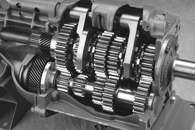

Jim, we were looking at our T5 case and most likely will have to mount the sensor to where it will read off of the cluster shaft as well. We are using a Racepak Sportsman box and will have to see if it will convert to the main shaft speed as well.

Mark provided us with his pattern for the jerico. If you can make a collar and drill and tap the case, it works great! I am sure that the same principle will work. You will have to see where it can all fit in there! It helps to have a friend with machinist skills. Easy work for them to figure out. I like being able to figure out when and how long the clutch slips. If you do that and if you have data from kyle carruthers clutch dyno, it makes life easier as far as clutch tuning is concerned. Especially if you have to adjust for heads up vs. Elims or track conditions.

Yes.....The Racepak sportsman can easily be configured to convert a cluster shaft mounted sensor to 1:1 for the input shaft. You need to know the number of teeth on the input gear and the cluster to do the math. Mine was 29/20 for a 1.45 ratio.
You need to change one number in the clutch configuration table to make this happen.
I bought my sensors from Greg Kelley(the guy that started this thread). He walked me through the process to re-configure in about 2 minutes.This, of course assumes you already installed the sensor in your Racepak/Laptop.
Greg can also help with this if you have any questions.
Also, in the configuration program, make sure you indicate if you have one or two magnets in your collar.(pulses per revolution).

No, I did not do the machine work myself. Chuck Buckshorn, friend, excellent machinist and long-time racer, actually made all the pieces. During the layout process, we discovered that the fill plug boss lined up, laterally, with where we needed to be on the cluster. The case was externally milled to adjust the angular alignment to the countershaft center line. I bought a length of, I believe, 1" aluminum hex rod that was machined into a combination fill plug/sensor adapter with o-ring seals. The split ring is very straight forward since there just is not sufficient clearance to allow very much variation of dimensions. I sold both of the modified Jerico transmissions without verifying that the design would work. However, the Jericos were replaced with Libertys, also modified by Chuck and they work with the standard Racepak clutch sensor and a single magnet in the countershaft split ring.
