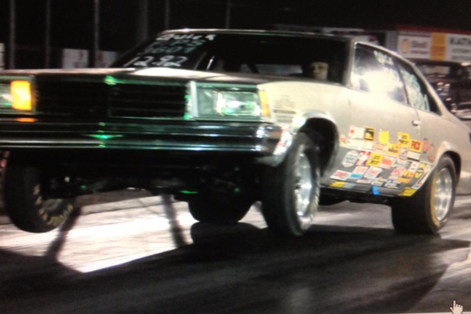

Default Re: Pure Stock Challange - Ohio May 2014
Here's my pure stocker picture Dan
Mike Taylor 3601
