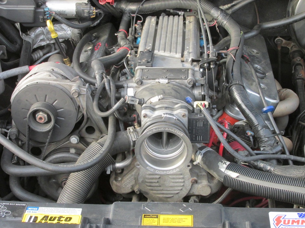

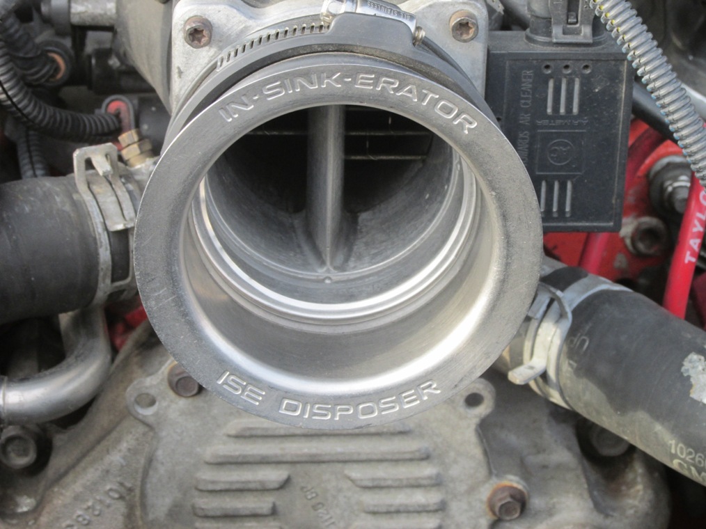

Here is my Engine with a Secret Velocity Stack..
Can you identify it?
D

Originally Posted by KennyAnderson View Post
1/2 a second from a cam and headers is AWESOME!!! What is your car rated at for hp Scott? What et's and mph do you run. I have a bud with a late model LS1 vette he built into an NHRA legal stocker with mainly just bolt ons. Runs quite a bit under the index. REALLY peaves the stocker guys when he drives it into the racetrack and goes waayyy under and goes rounds.
D
I use to remember getting those for the LT1s Dan at my local plumbing supply store. Always got a funny look when you told them what it was for.
D
SWEET! I have one of those in my kitchen right now! Wonder if momma will miss it?? LOL! How much was that worth Dan? As quirky as these things seem I wouldn't be surprised if it picked you up a dime.

Default Re: B/PS lt1 formula
The Last time I replaced the garbage disposal.
It came with a new Drain.
Noticed the Drain was 3 inches. Remembered the B-body MAF was 3 inches.
Used a coupling from the original First and Second base intake set up.
Fit like it was designed that way.
Do not know if it adds HP. But leans in that direction.
At the track it gets a lot of big smiles.
D
