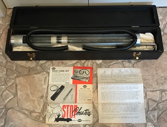

Default Re: Problem with lash closing up
P&G made the valve gapper and the cubic inch tester (pump)...gsa612
