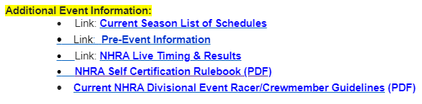

I am not sure what opinion I have on the tech at any time, but this policy is in place at any time. I don't really think it matters if we are OK with this or not, it is what it is. Per the new self-certification rulebook introduced in 2021 and found at the below link:
https://www.nhra.net/2021/nhraracer/...n_Rulebook.pdf
"Technical inspection can occur at any time before, during or after an event, at the time and in the place and manner directed by the NHRA Tech Department or any designated event official, and regardless of the technical inspection category that applies to the participant. Therefore, the participant must be prepared to demonstrate compliance with all applicable NHRA rules at any time."
Additional quote: "All determinations by event officials regarding the timing and method of technical inspection are final and are not subject to appeal or review."
While I have my own opinions on the timing and tech inspection, the NHRA officials followed the rules as set forth and distributed by email that we all receive in every national event entry information email.
