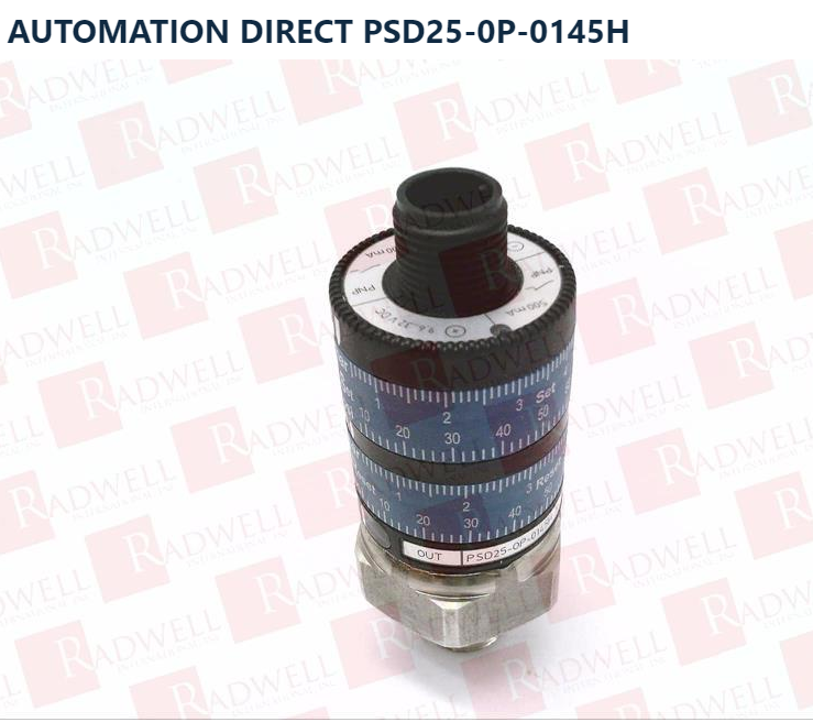

here is one.Does it look close?

Folk Race cars closed. The switch you want has an adjustable pressure Range 100 to 1000 PSI. 3 wires. Black wire is not used.
Recommend wiring power to it thru a 3rd gear micro switch.
Power is removed to the BPS when in 3rd gear ( if a 3sp Auto)
This will allow you to apply brakes at 1,000 and the 2 step will not be activated.
Set up a LED light in the circuit so you know when the 2 step is powered up with right brake PSI
Believe they are 200.00 or so.
