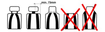

Did they forget this important information?
