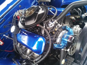

The 287 manifold would be considered "flat"compared to a 68-69 396/325 (shown).There not as restrictive as you may think,as the 71' 454/365 Chevelles and Corvettes use it,with 50+ more ci.and the same cyl. head (#820). gsa612
