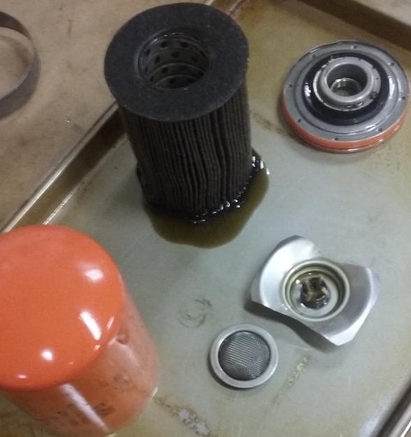

Default Re: Oil Filter Comparison
Looks like the construction is the same as the street version . End caps are cardboard , the bypass valve , under the screen looks well designed with a coil spring .
