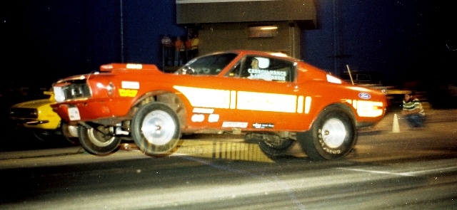

Well I don't have the answer either, but I will say that flashes can do weird things. I have taken hundreds of pic at the track and this is the only time it has ever happened and I have pics of the same car when I did not have a flash that were just fine. I used a medium grade Vivatar always set to manual mode. The panels on the car WERE reflective tape. Why it came out this way is still a mystery to me, even 30 years later.
