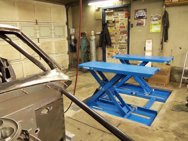

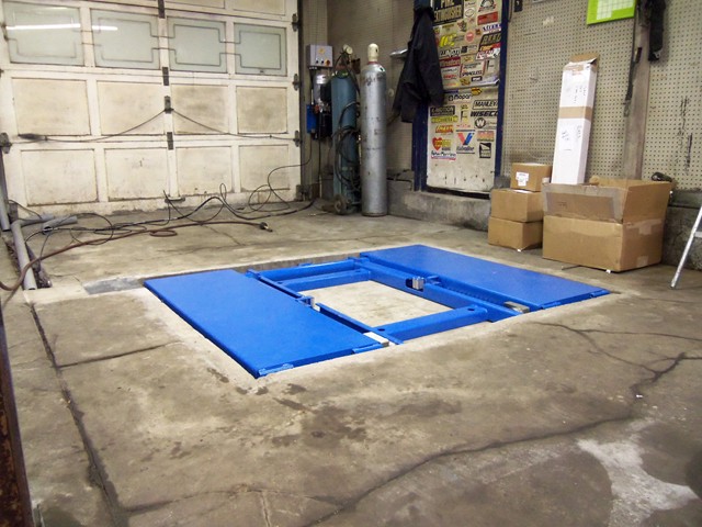

Heres an idea for some of you with limited celing height or very low cars.
I got this 48" scizzor lift from Greg Smith Equip. in Delaware.
It's about 5" high,and I recessed it flush with the garage floor so even the lowest tube chassis car will go over it.
Very sturdy and only about $2k

I've seen Tommy's deal up close and its really slick ......only downside I saw was that you better be friends with someone who can do concrete work .

Hey Tom,
What is the lift rated at.

Ken the lift is rated at 7000 pounds.
Its very well built and the travel speed is good ,not snail speed like some are .
I think I have some info on it ,I'll bring it along to Atco.

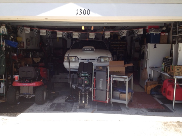

i think i am ready for a new garage, this is what i have now,( have to use the dining room table for hood storage). i bought the lot next to my house an plan on putting up a 25 x 30 garage one day. lots a neat ideas in this thread.
