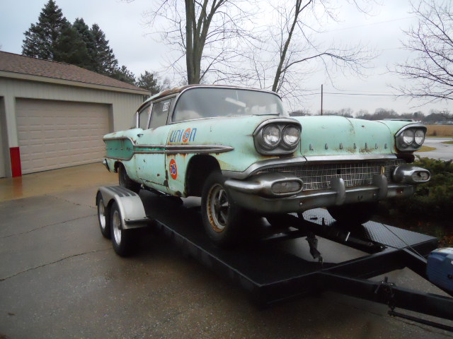

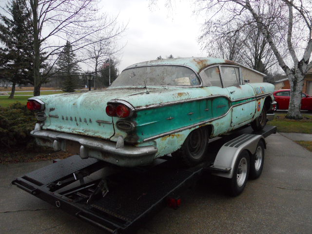

Does anyone here have any idea how much a 58 Chieftain weighed in at(race weight) back in the day?
I would really like to know what Ramon's car weighed.

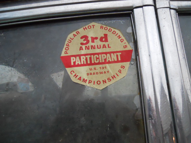

I'm working on a 58 Chieftain that was raced back in the 60's, up through the early 70's when NHRA changed the stock class rules that bumped 10 year old(or older) cars out of stock class drag racing.
I'm hoping to have this back on the track within the next month.
This car competed at the first 3 Popular Hot Rodding Championships at US131 Dragway, Martin Michigan in 69,70,&71

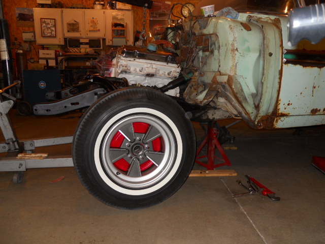

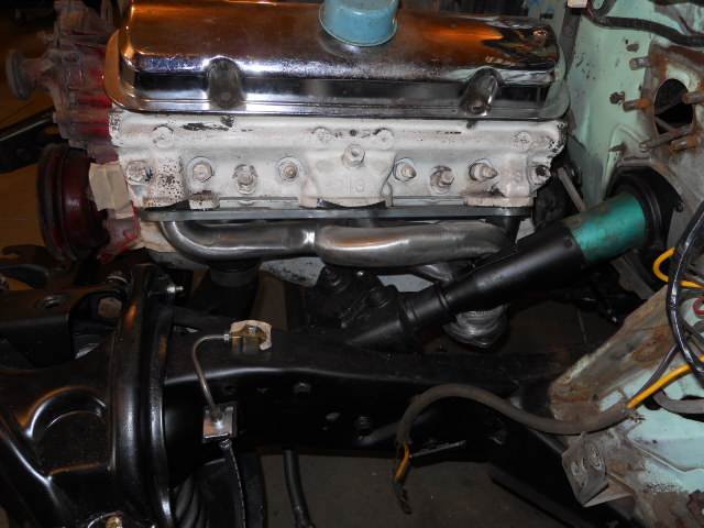

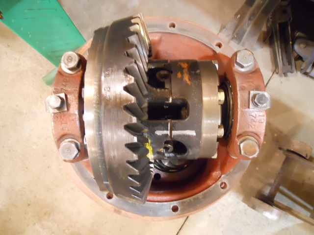

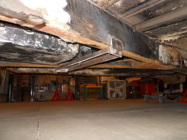

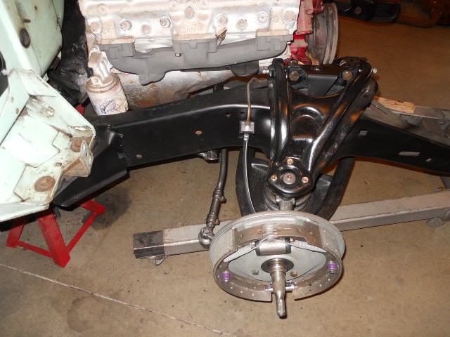

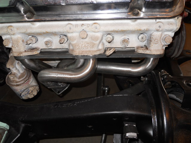

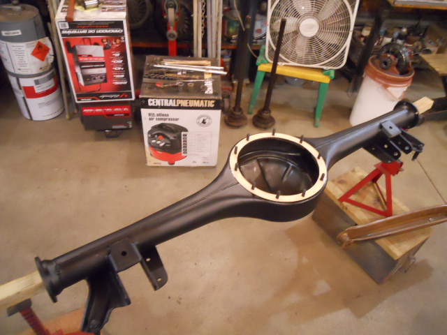

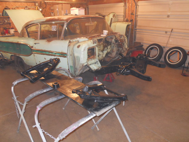

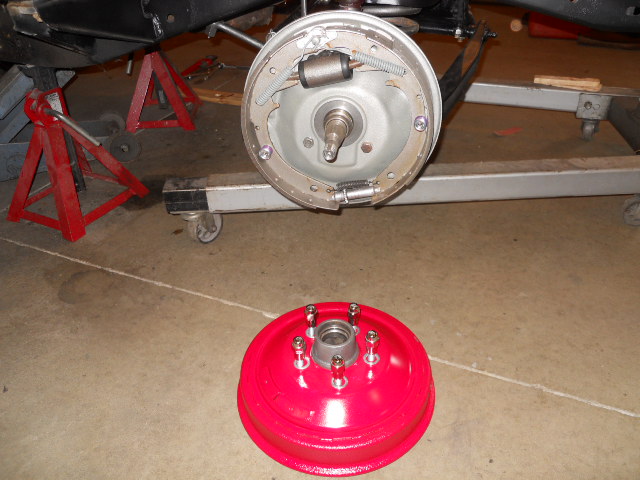

putting a 67 400 in the car with a 700R4 trans, back to the 4.30 Safe-T-Track rear.
