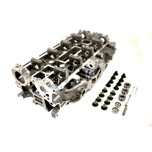

It better have the stock exhaust manifold as it is cast into the head, wonder how they check the exhaust cc's on this one for a teardown? Has anyone actually looked at this motor or is it just something they read about in Hot Dog magazine?
Here is a picture of the exhaust side of the head.
Roland
rawhide is offline   Reply With Quote

here is the description for the head from the Ford Performance website.
Fits 2015-2018 Mustang EcoBoost engines
This is the production IEP (integrated exhaust port) cylinder head
Includes water jacket plugs and valve seals
Does not include valves, valve springs, retainers, valve locks or tappets.
Same cylinder head used in Brad Gusler's NMRA 1/4 mile record setting EcoBoost Mustang
