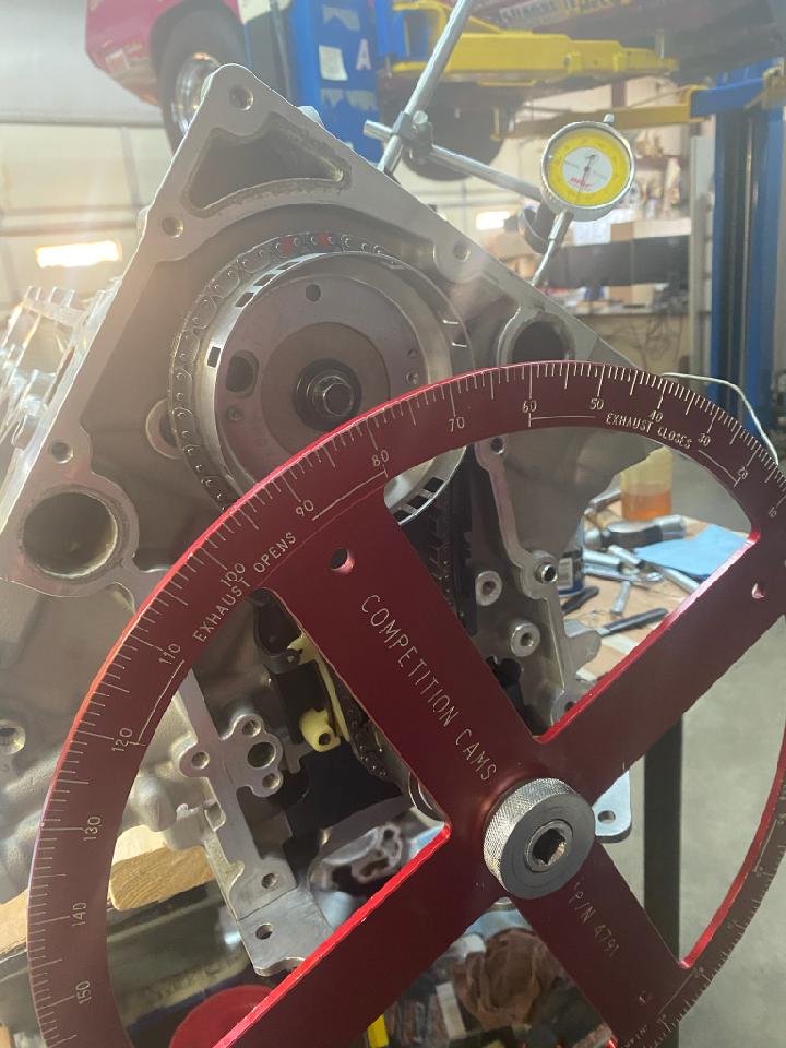

Getting ready to check where the cam centerline is.

Cam is where it’s supposed to be. I should be able to fill some more holes and stretch some bolts tomorrow.
