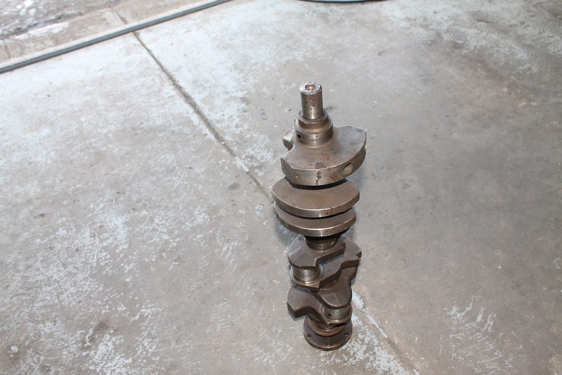

I've always been fascinated by first generation Z/28s, which brings me to my first engine rebuild, a 1966 October 657 casting block with matching 462 casting heads. I will post pictures as I go along. The first pictures show the core cleaned along with the block prepped for machine work which I will start this coming week.

I have a fresh lg journal 302 crank for sale if you need it. Just balance and go. PM me if interested

Thanks, but I have a crank. I will have it ground and indexed, and the stroke will be set at 3".
