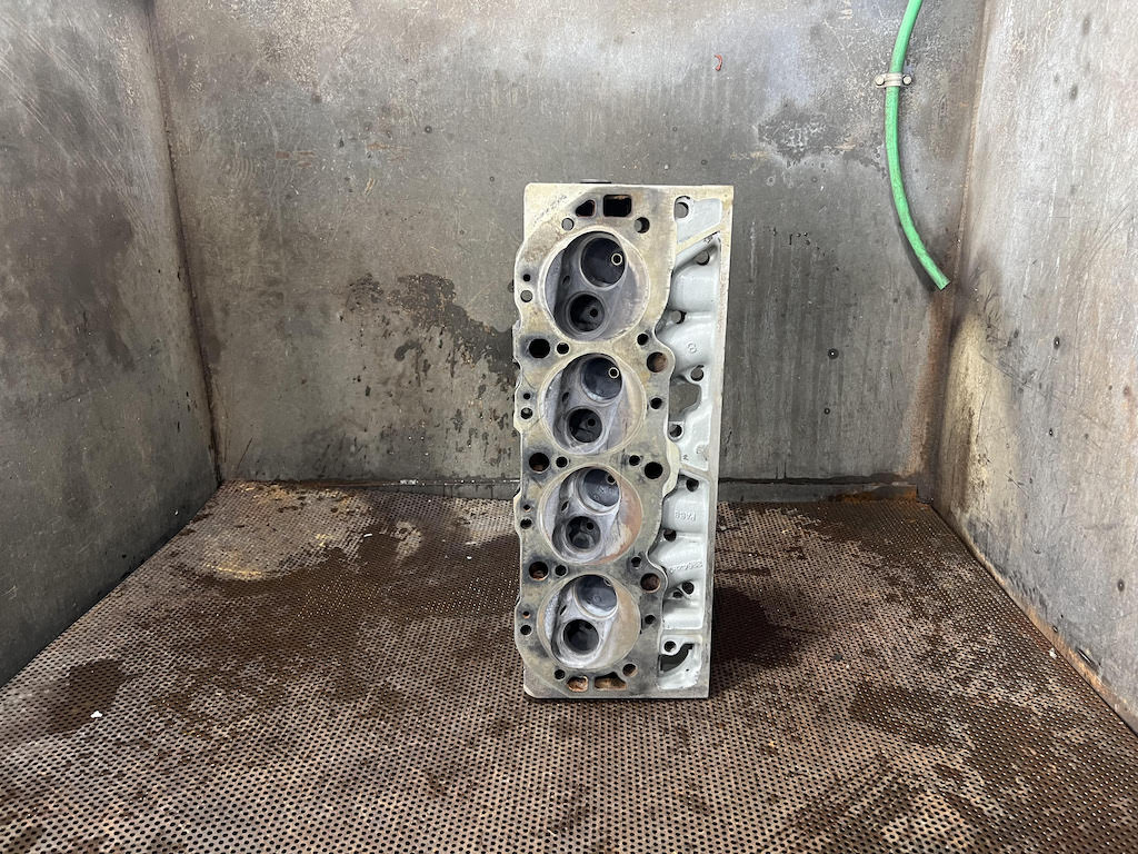

A while back I was looking for a transmission and came across a complete 335 HP 396 Stocker drive train for sale and and bought it. From what I've been told this engine/trans ran 3-5 tenths under the index in D/SA trim, dyno data also came with the engine which I will share as well. My plan is to go through the 290 head castings and see if I can make some improvements then dyno test the engine and finally run it in the car. I tore the heads down and preliminary cleaned them for a flow test, which I will post as the car ran 3-5 under the index. I will be testing the other head as well before any work starts to make sure it's similar in flow to the first head tested.

In the picture its hard to see but both the intake and exhaust valves are sunk quite a bit, probably to get CCs and piston to valve clearance, which I will check so I can get my heights setup before any work is done. Flow testing was done @ 28 inches, 4.350 bore, SF 600.

One thing to note, when a BBC head is flat milled to the extent this head is, flow is lost, although I understand CCs have to be met some way, it's definitely a juggling act. At this point I will clean the head, then locate the highest (closes to the piston) intake and exhaust valve and check piston to valve clearance then CC the chambers, after this the cylinder head restoration will start with pictures. If anyone has flow data for this type of casting in Stock Eliminator trim casting numbers, please feel free to post along with opinions.
