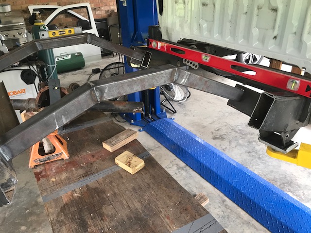

We are beginning the frame modification. The new section will be 5 1/2" inboard of the original frame. Once both new sections are properly installed and aligned, the original frame will be cut away. Having the OE frame remaining in place gives a good fixture for accurate alignment.
