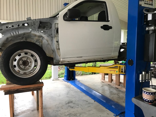

Working on a truck is a beautiful thing! Remove the bed, complete access to modifying the rear suspension. After a time of thought, I plan to install a set of ladder bars. They will do everything I want in this situation. I will also install them about 4" inboard of the factory frame so that if in the future I want a larger tire it will be an easy upgrade. Installing a Chevy 12 bolt will also be part of this exercise.
Here she is on my trusty, home-built tables that allow placing components at ride height and allowing a good view of the fitment.

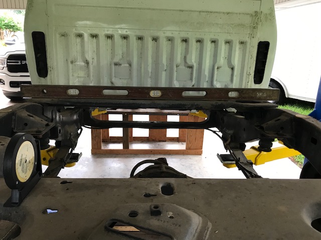

In the first photo, the front springs are removed so the suspension can be blocked at ride height.
The second photo shows the chassis blocked at one degree forward rake.
The third photo shows the chassis blocked level.

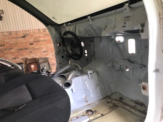

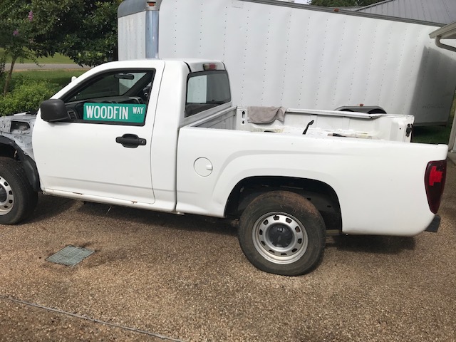

When converting a factory stock truck to a drag race truck, it is necessary to turn all bolts anti-clockwise. Later, after modifying each piece, bolts can be turned clockwise.
