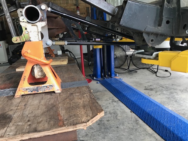

ladder bars

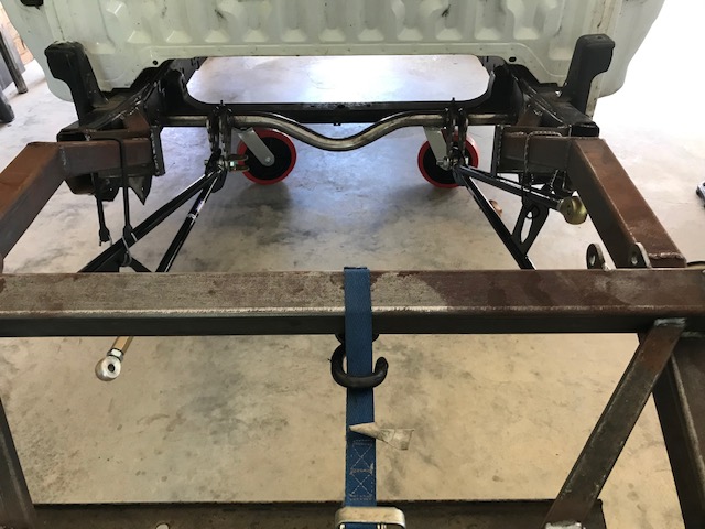

Competition Engineering Anti-roll bar

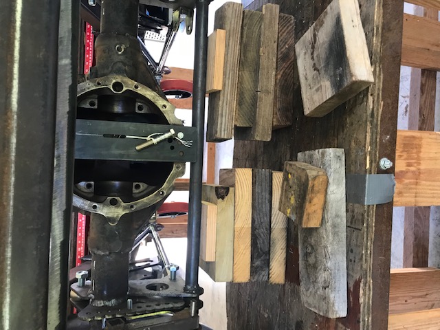

It is not necessary to have caster wheels, but it helps.
