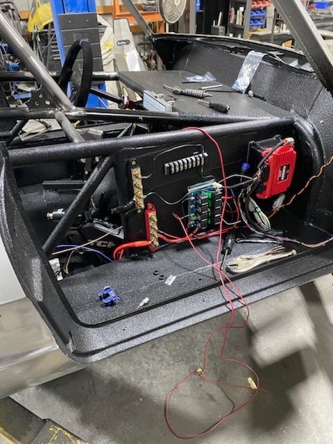

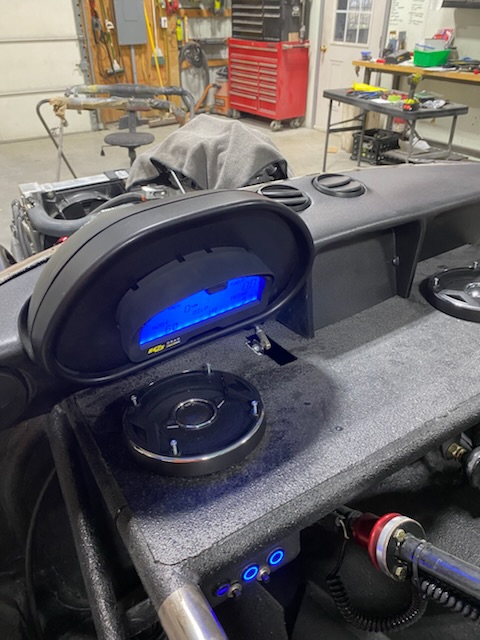

Moving on to some wiring, and stereo installation, you know, the important stuff

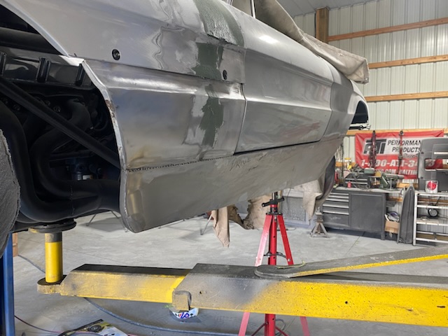

Time to start on the outside body work, I made new rocker panels to fit the extensions and to level the cars stance to 4-1/2 off floor

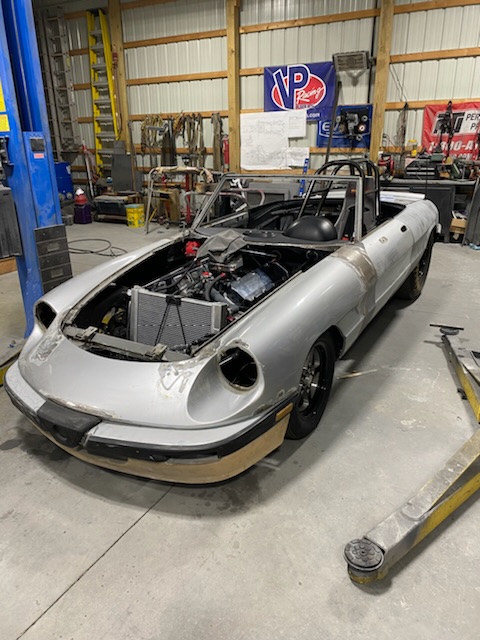

I need to add that I made the front end removable, it can tilt or slide off, the hood opens from the rear. That was nice because I could get a nice tight fit from the scoop to the windshield. The cowl panel is now in 2 pieces and is removable for engine servicing

How tight will it be to reach the 3 back plugs?

Originally Posted by nickh View Post
Keith Love the build, you may have found a second calling..LOL
Thanks bud, and it's really not bad, especially if you take the three fasteners out of the cowl and remove, all open to the windshield. hard part is if you need to take the distributor out, engine has to go. but still not bad
