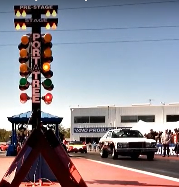

I wish this was an issue that was underpinned with honesty, but that is not the case. I?m not upset about losing the round nearly as much as being blamed and flat-out lied to.
Once I debunked the technical BS they slung at me, then the tone changed to yes, we admit that there was indeed a problem. However, no reruns were allowed to other complainers. Once I debunked that BS, then I was told that there would be a rerun if my opponent agreed. He agreed, but then I was told that there was no time for a rerun (10 cars left at 3PM). FINAL DECISION (now go away)

Staging lights and red bulb are all illuminated!Click image for larger version

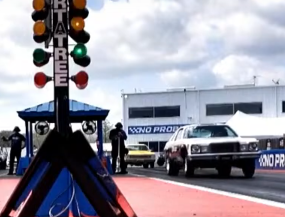

Here's a shot from Thursday. The last amber and green lights both illuminatedClick image for larger version

ID:	72272!NHRA knew about this problem on Thursday but proceeded to run eliminations anyway and we should all be concerned about the deception. I know Lee Zane lost his class final because of this. Who else got hosed?
