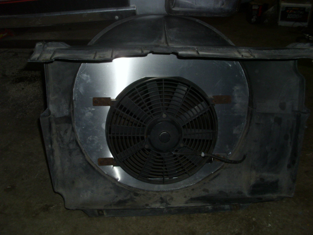

Well, I spent a nice quiet, snowy day in the shop yesterday. I took out the fuel tank and modified my pickup and got my fuelpump installed. Just a headsup on the fuelpump, don't ever throw anything away! Dug out my box of "bad" blue Holley pumps and spent some time just putting parts together until I came up with a pump that works and doesn't leak. I will have to spend a few bucks on fittings and a regulator diaphragm but the fuel system won't break the budget. I guess those years of digging through dumpsters and friends garbage cans is starting to pay off!
Today, I am going to put a broken factory fan shroud back together and mount a cooling fan in it. I'll try and get some pics later.

$10 used cooling fan and a piece of scrap aluminium fixed my broken shroud and will work well.
