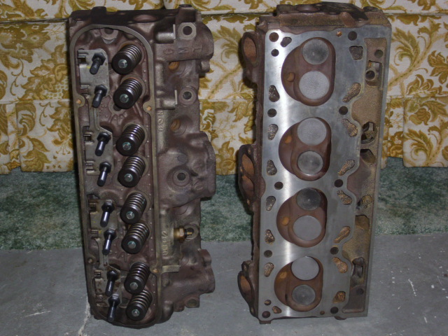

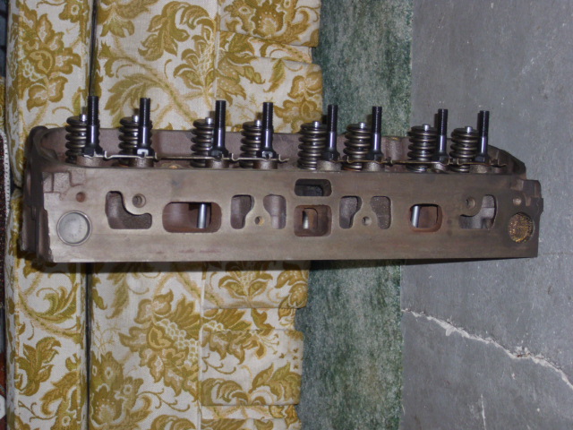

I got my heads done today thanks to my old buddy Al Grabinski who lets me use his shop to do my stuff. Also for letting me dig through his garbage for stuff like valve springs retainers and rocker studs that he won't reuse on his race boat motors.
Extra special bonus points to the first person who can tell me which holes in the 301 head are intake ports (Yac can't play).

2 rectangular holes are intake ports and are siamesed and each feeds 2 cylinders...
I worked on them a lot when they were new but can't recall ever seeing those puny ports....
I did replace one brand new block in a car exactly like yours for a porous casting....It leaked water right thru the casting on the drivers side....
I was given a fitted block.....block with pistons/rings.......
Some if I recall right had full size Q-jets but the secondarys were not there...
Then the Dual jet version came along...
Now keep in mind this is all vague memories form the late '70's
The 301 was pretty snappy in a GP but ran out of snap pretty quickly....LOL
The 260 Olds V8 was a total dog.....
I am guessing they had the Metric 200 transmisions and the steep first gear is where the "snap" came from.......
Pinging was a serious issue with these cars....GM was really producing some terrible cars back then and I worked on them everyday in a Pontiac-Jeep-Subaru dealership....

The last time you had a perfectly stock set of heads it didn't turn out so well - haven't you learned your lesson ?
Trust me Jack, they're "stocker" heads. The only thing that I would improve on would be aftermarket valves but they're not in the budget. The stock 301 intake valves are pretty nice to begin with and the exhaust port is WAAY better than the intake so the exhaust valve won't help much.
