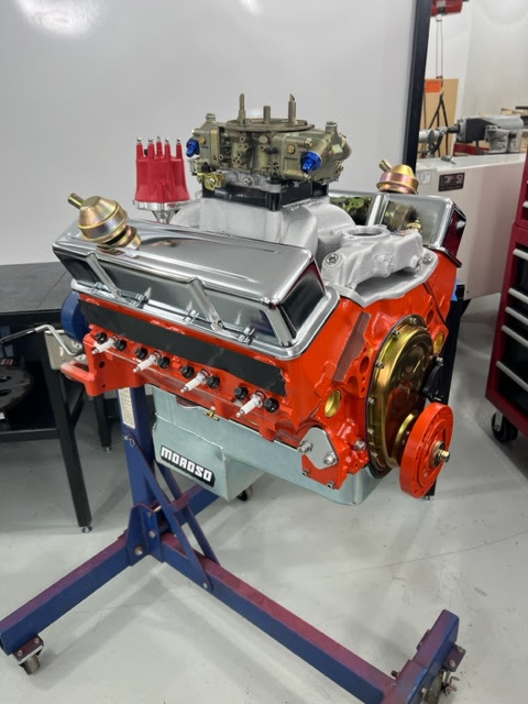

Default Re: 1979 C-10 Shop/Race Truck Build
So I started my 350 build, .060 over 2 bolt 010 block, I did some work to the factory cast crank which ended up @ 3.483 stroke, I put a 6 inch rod in there with a + 6 cc dome Mahle piston, my Fuelie heads came in at 74 CCs which gave 10.8 compression. My solid lifter cam was .528 lift @ the valve with 264 @ .050 duration on both sides, 108 lobe separation. I used a Performer RPM intake with a 750 Holley, the Moroso pan was modified.
A picture of my new 350
