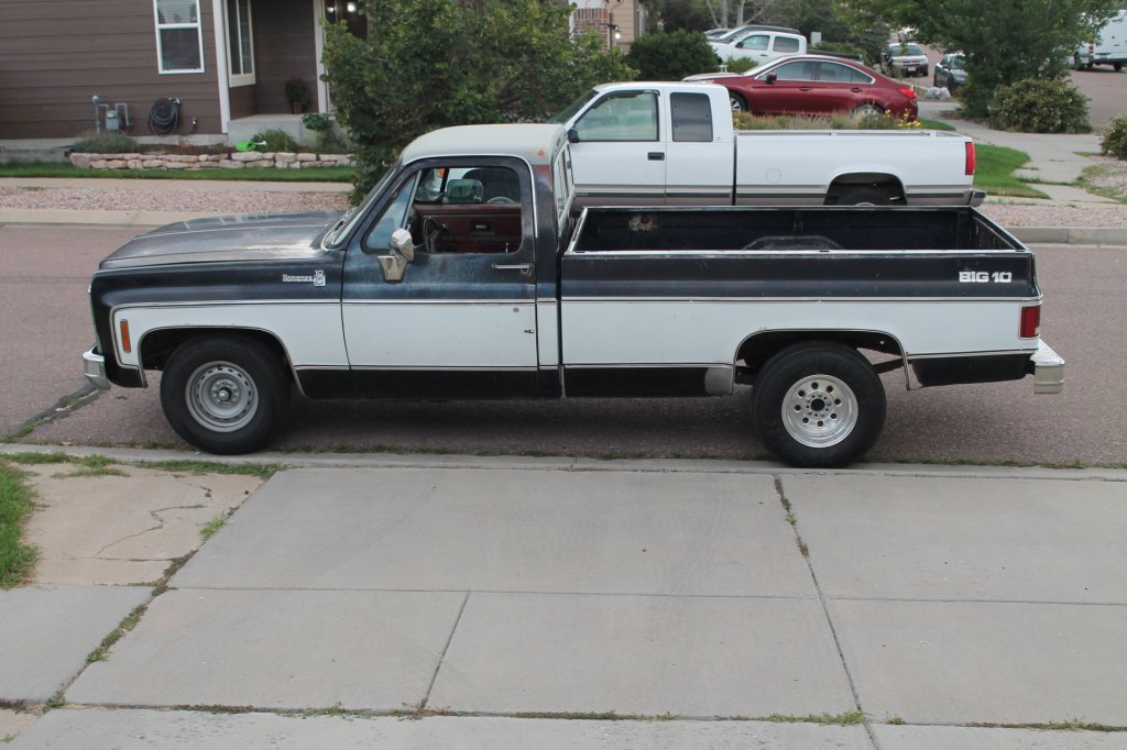

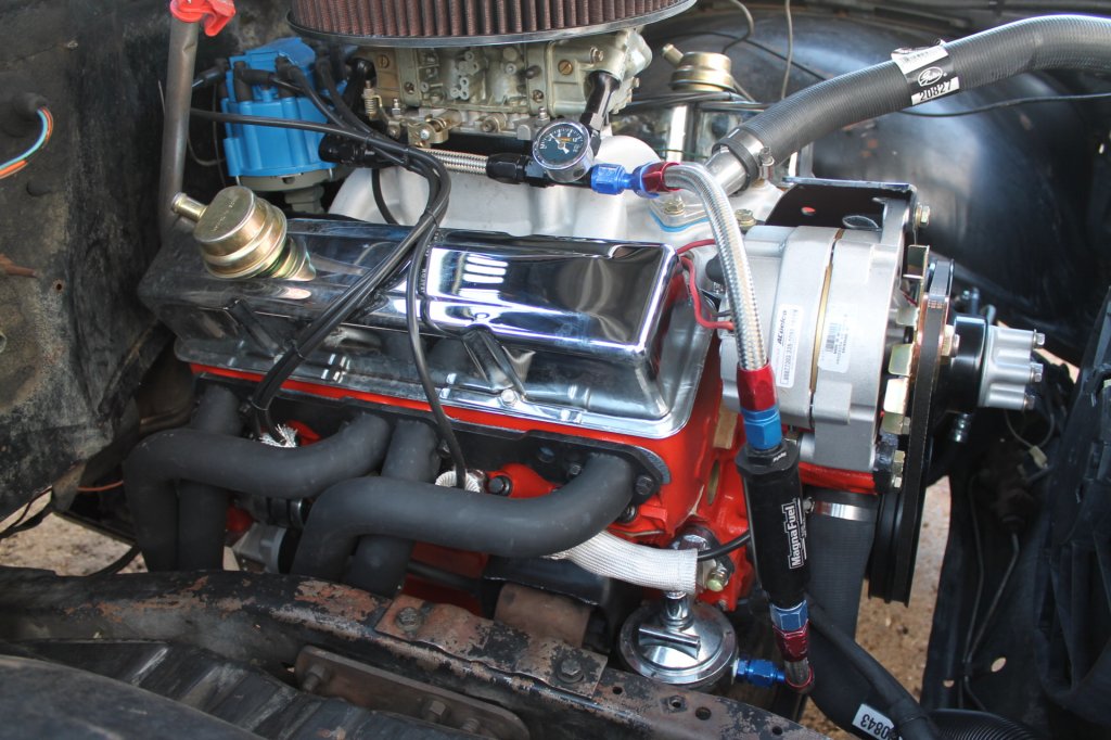

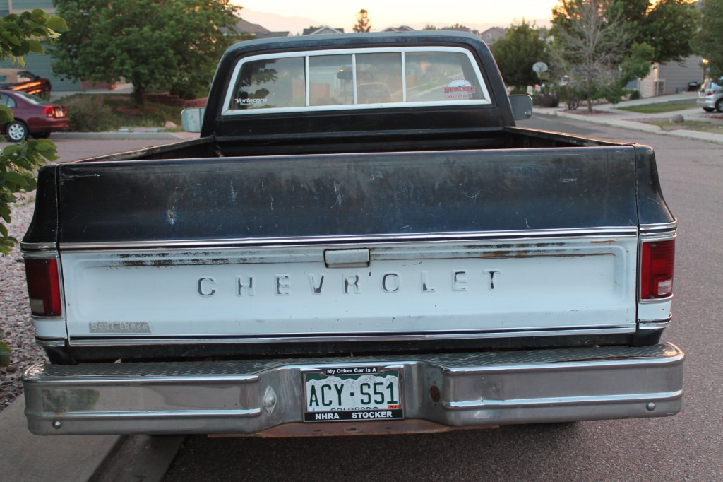

8 years ago we bought this truck with the intention of building a shop truck we could race on Friday nights, and also get my 11 year old son involved with the build. My plan was to build a low buck truck and show my son how to use parts most would through away. Our first engine was a 327 backed by a Turbo 350 and the factory open 3.42 gear, my son learned how to build a engine on the 327, we paid 100.00 for the virgin core. I will go through the build as we built it, our goal now is to run 6.80s in the 660. Heres our plan.
Picture of the truck and first engine (327)

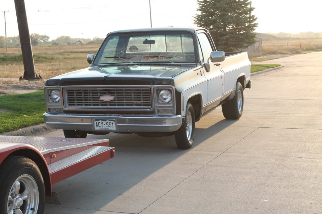

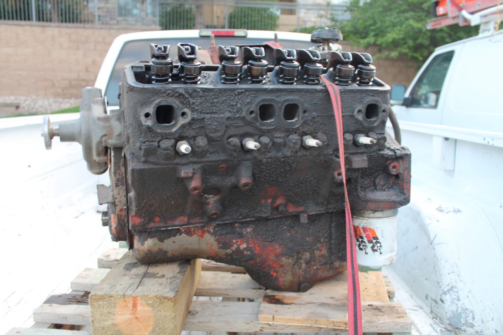

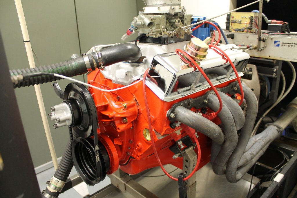

Our 327 on the dyno, 11.1 compression, 462 fuelie heads, 480/240/108 SFT cam, Performer RPM intake, 750 Holley. Track performance was 13.90 @ 101 MPH going through in second gear (3.42 gear) in Colorado's thin air.

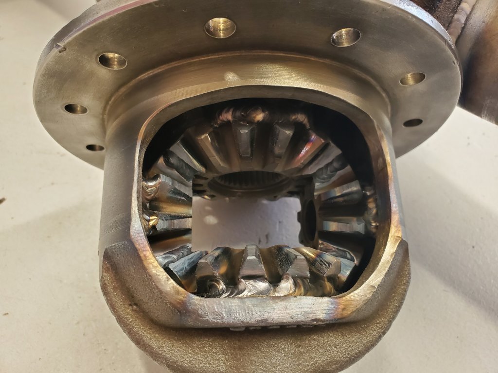

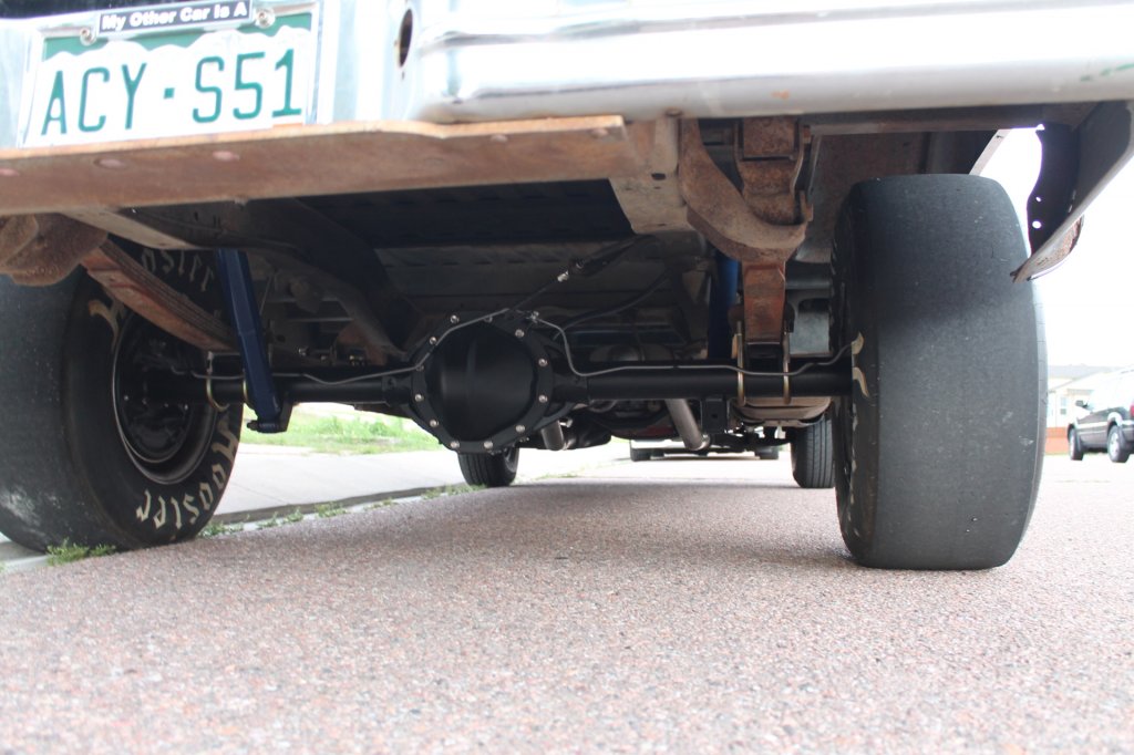

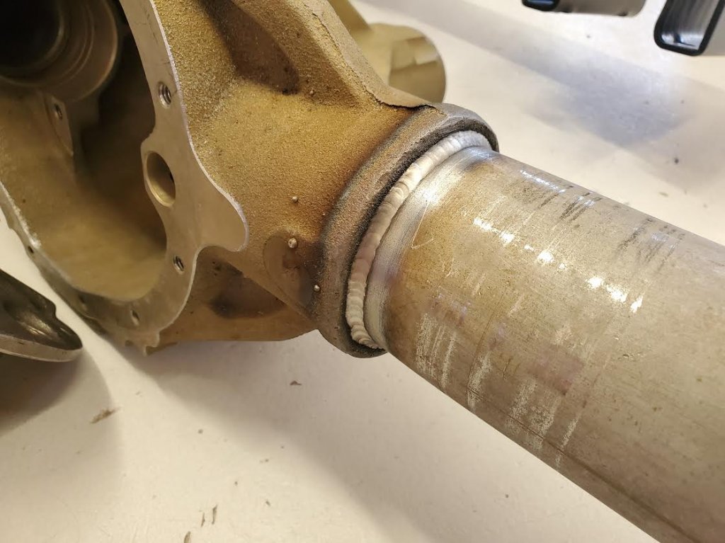

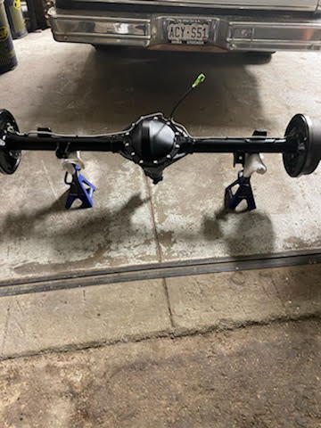

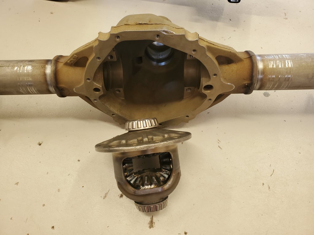

The next order of business was to build a locked rear end with 5.13 gears, so we bought another truck 12 bolt and built it cheap. Some pictures.

Known as the "Lincoln Locker" in this part of the country. Hard to keep the run out down but seem to last forever on the dirt.

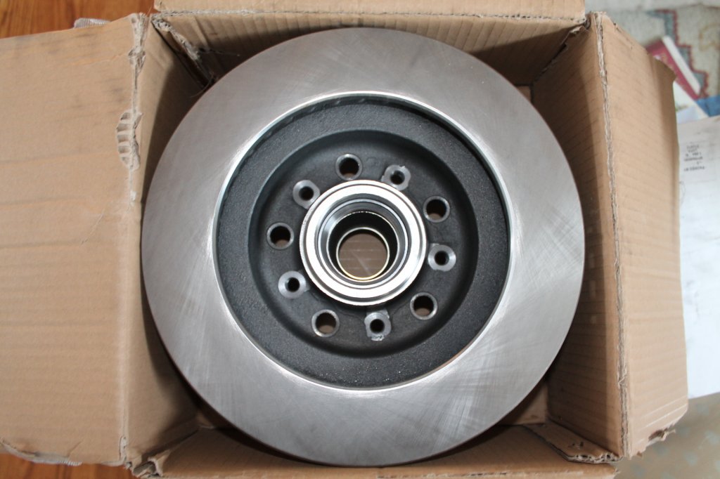

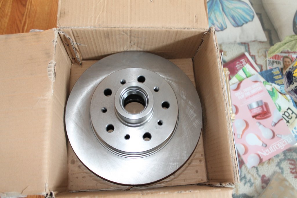

When the rear end was installed we went from a 13.9 to 13.4 ET at high altitude, but I still felt the truck didn't pull through low gear like it should, 1.92 60 foot, knowing the stocker trucks went 1.77 @ Denver this bothered me, although I knew they were 300 pounds lighter, but didn't have my HP. My focus turned to the driveline which is a disaster on a 79 C-10, heavy rear brakes, heavy discs up front, which only accept a heavy tire rim combination, 6 lug. So I looked at the Lamb front brake setup and decided I didn't want to spend the money and wait (wish I had) so I tried to go the LM1 Camaro front disc setup which required I believe a 1981 and newer front spindel, but could never figure out the caliper setup so I had the original style heavy front discs redrilled for a car bolt pattern. I now could get a race style front tire and rim on the truck. I still had the ultra heavy 2 piece drive shaft robbing me............................
ID:	68841   Click image for larger version
ID:	68842   Click image for larger version
Name:	RACE TRUCK.jpg

Heres some information on the 327 build:
Heads from start to finish maybe 40 hours approx
Flow @ 28 inches SF 600 4.030 bore, 2.020 Intake valve
.200 don't remember
.300 193
.400. don't remember
.480 239
Peak 259 around .650 lift
Hp was 445 HP @ 6600 RPM
TQ was 400 for one RPM point, 390s flat for a long time
